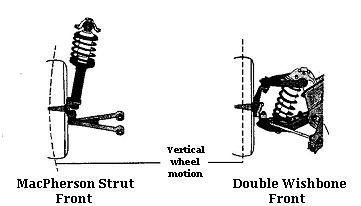

Since ride height alters the camber of the wheel on McPherson strut suspension type, does anyone have experience regarding excessive tyre wear?
I will explain with a picture:
We can see on the left picture how camber of the wheel changes within suspension travel. So logically, lowering the ride height does alter this in some way. But i have no idea how much ...
Did anyone with lowered suspension noticed tyre wear or any other similar issue?
